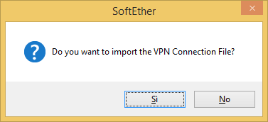

Now you can install the software always clicking “Next” e without changing any settings except, if you want, the directory. Once this is done, click on the file that you have been given together with credentials e click on “Yes” when you see this dialog box:

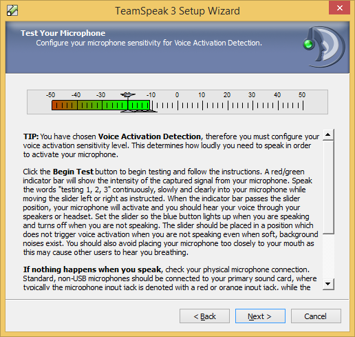

- speak normally and at the same time adjust the slider so that it is 4-5 notches before the peaks of the indicator bar:
